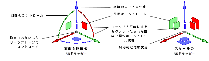

The 3D dragger's linear, rotational, and planar controls
